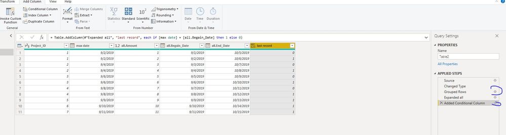

  • Hi Anonymous
    First, add a column to show which record is the last one for each project id.
    assume the max "start date" for eact product id is the last record.
    in Table2, group by "product id", then add a conditional column
    you can click on the icon(blue circled) to see details.
    Code in Advanced editor.
        Source = Table.FromRows(Json.Document(Binary.Decompress(Binary.FromText("VdDdCcAgDATgXXwWNP47i3T/NdqcbXOCgomfEm4tJ85jzyAhRZlaxlD3+fIbJIBEoBnQywyQCfQTFIBCYBjQ1xWgEpgnaACNwLN+of93iM5CTjEgBotkAiNATBbZRENrpxXZFDM6hbyJcqTyZXrd", BinaryEncoding.Base64), Compression.Deflate)), let _t = ((type text) meta [Serialized.Text = true]) in type table [Project_ID = _t, Amount = _t, Begain_Date = _t, End_Date = _t]),
        #"Changed Type" = Table.TransformColumnTypes(Source,{{"Project_ID", Int64.Type}, {"Amount", Int64.Type}, {"Begain_Date", type date}, {"End_Date", type date}}),
        #"Grouped Rows" = Table.Group(#"Changed Type", {"Project_ID"}, {{"max date", each List.Max([Begain_Date]), type date}, {"all", each _, type table [Project_ID=number, Amount=number, Begain_Date=date, End_Date=date]}}),
        #"Expanded all" = Table.ExpandTableColumn(#"Grouped Rows", "all", {"Amount", "Begain_Date", "End_Date"}, {"all.Amount", "all.Begain_Date", "all.End_Date"}),
        #"Added Conditional Column" = Table.AddColumn(#"Expanded all", "last record", each if [max date] = [all.Begain_Date] then 1 else 0)
    Then create Table 3,  in Table 3, merge table2 with Table3, filter rows, then add two column to show new "start date" and "end date" by adding 1 year.
        Source =Table1,
        #"Filtered Rows" = Table.SelectRows(Source, each ([#"Renewable_Y/N"] = "Y")),
        #"Merged Queries" = Table.NestedJoin(#"Filtered Rows", {"Project_ID"}, Table2, {"Project_ID"}, "Table2", JoinKind.LeftOuter),
        #"Expanded Table2" = Table.ExpandTableColumn(#"Merged Queries", "Table2", {"all.Amount", "all.Begain_Date", "all.End_Date", "last record"}, {"Table2.all.Amount", "Table2.all.Begain_Date", "Table2.all.End_Date", "Table2.last record"}),
        #"Filtered Rows1" = Table.SelectRows(#"Expanded Table2", each ([Table2.last record] = 1)),
        #"Added Custom" = Table.AddColumn(#"Filtered Rows1", "new begain date", each Date.AddYears([Table2.all.Begain_Date],1)),
        #"Added Custom1" = Table.AddColumn(#"Added Custom", "new end date", each Date.AddYears([Table2.all.End_Date],1)),
        #"Removed Columns" = Table.RemoveColumns(#"Added Custom1",{"Renewable_Y/N", "Table2.all.Begain_Date", "Table2.all.End_Date", "Table2.last record"})
        #"Removed Columns"
    Maggie
