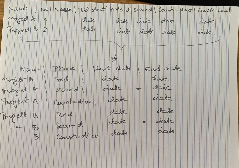

Hi everyone,
I am a Power BI novice and need help with creating a new table using columns from another table. The original table is very large, with a lot of other columns, but I summarised the columns that I need to bring it into a new table as per the image below.  There are multiple projects that have start and end dates for the different project phases. I would need to create a column with the phases associated with the various dates, and then display start and end dates as per those phases. So I need to combine the various date columns into just two: start and end dates and those dates to be associtated with the phase. Hope this makes sense.
This seems rather complex to me, and woud appreciate some help in creeting this.

dufoq3
Hi @KatiS, provide sample data as table so we can copy paste, and expected result based on sample data. Thank you.

KatiS
Name NoBid Start Date Bid End Date Secured DateProject Start date Project end date
Project A12/03/20241/05/202431/05/202415/06/202415/06/2027
Project B215/07/202413/10/202412/12/20241/02/202531/01/2031
Convert to
Name NoPhase Start Date End Date
Project A1Bid2/03/20241/05/2024
Project A1Secured31/05/202431/05/2024
Project A1Project15/06/202415/06/2027
Project B2Bid15/07/202413/10/2024
Project B2Secured12/12/202412/12/2024
Project B2Project1/02/202531/01/2031

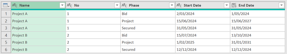

Result
    Source = Table.FromRows(Json.Document(Binary.Decompress(Binary.FromText("i45WCijKz0pNLlFwVNJRMgRiI30DY30jAyMTEF/fwBTGNkbmGJrqG5hhcMyVYnUQBjqBDINKm8PVGusbGsA5RvpAhLALzDaF2mUI5BgbKsXGAgA=", BinaryEncoding.Base64), Compression.Deflate)), let _t = ((type nullable text) meta [Serialized.Text = true]) in type table [Name = _t, No = _t, #"Bid Start Date" = _t, #"Bid End Date" = _t, #"Secured Date" = _t, #"Project Start date" = _t, #"Project end date" = _t]),
    #"Unpivoted Other Columns" = Table.UnpivotOtherColumns(Source, {"Name", "No"}, "Phase", "Value"),
    #"Split Column by Delimiter" = Table.SplitColumn(#"Unpivoted Other Columns", "Phase", Splitter.SplitTextByEachDelimiter({" "}, QuoteStyle.Csv, false), {"Phase", "Date Type"}),
    TransformedDateType = Table.TransformColumns(#"Split Column by Delimiter", {{"Date Type", each if Text.Lower(_) = "date" then "Start Date" else Text.Proper(_), type text}}),
    #"Pivoted Column" = Table.Pivot(TransformedDateType, List.Distinct(TransformedDateType[#"Date Type"]), "Date Type", "Value"),
    #"Replaced Value" = Table.ReplaceValue(#"Pivoted Column",null, each [Start Date], Replacer.ReplaceValue, {"End Date"})
    #"Replaced Value"

KatiS
Thank you. It looks perfect! exactly what I am after. I am bit lost, however, as to what the code in the "Source =...."  means and what sections in the code do I need to adjust at my end to connect to my table. My original table is called "Data". How do I link what you have in your Source code to my "Data" table?
