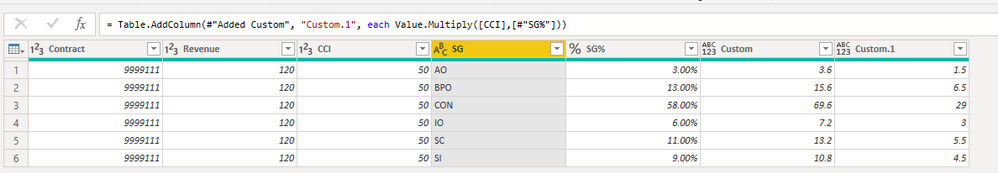

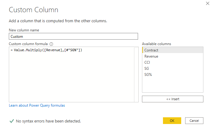

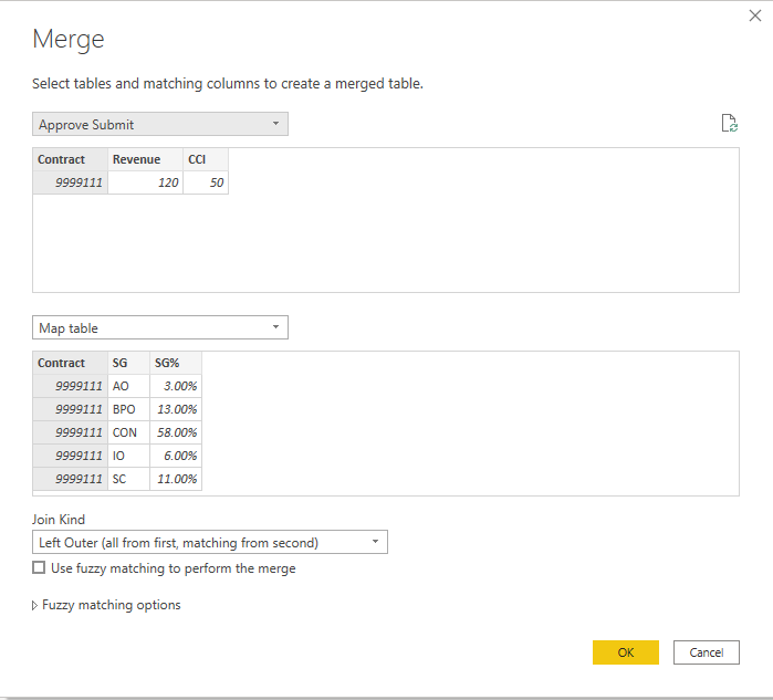

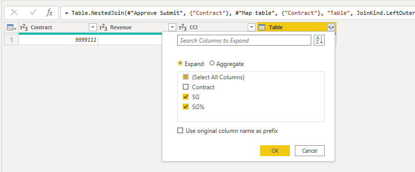

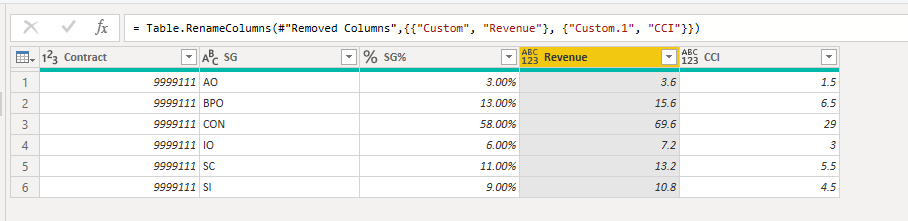

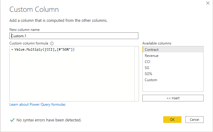

        Hi cristianml ,
        1.Merge two tables
        2.Expand the table
        3.Create two custom columns
        4.Remove the unwanted columns and rename the custom columns.
        More details you can check the attachment.
        Stephen Tao
