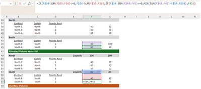

This is for a financial model of a pipeline, and I’ve created a dummy data file for explanation purposes. I would say I’m a pretty advanced power user, but this one is a headscratcher for me. I found that others used filebin to share files so I've included a link, but I also uploaded images of the file.https://filebin.net/534tip1p43i3qhi4
Overview: There are different pipeline “systems” (aka North/South) and each system has a max volume capacity that it can operate at. There are contracts that operate on each pipeline system (aka North A, North B, etc.), and they have a priority ranking that dictates the pecking order of capacity on the pipeline. The rank matters in the instance where there are more volumes than the system can handle, and the volumes will be reduced accordingly.
Context: The actual file has around 200 contracts, with 30+ systems, and has volume forecasts up to the year 2030, so there’s a lot of data. There’s also instances where one subsystem has 9-10 contracts, so it doesn’t seem efficient to build this using Boolean logic in Power Query (which is the only way I can think of).
The Ask: I’d like to recreate the Power Query output table using M code rather than excel formulas. In the model, this is something that would rarely be updated, and so I’d rather have all the compute upfront in power query. The output table will then feed other schedules that I’ve already built.
Any help on this would be greatly appreciated!

I have attached an updated Excel workbook with one approach, and I am sure there are many possible variations!
One initial question:
  • It looks like the volume allocated to South A on 1/01/2026 should be 40 rather than 20. Is that right?
    My Power Query method produced 40 (Capacity = 80 with South B Vol = 40 & South A Vol = 60). I haven't unpicked the Excel formulas to fully understand what's going on though.
  • This was the only difference between my outputs and yours.
Summary of the process I followed in Power Query:

        VolumeAllocated              = List.Min({CapacityRemaining, CurrentVolume}),
        VolumeAllocatedCumulative    = VolumeAllocatedCumulativePre + VolumeAllocated,
        VolumeUnallocated            = CurrentVolume - VolumeAllocated
      each [Index] < ItemCount,
      each [
        Index                        = [Index] + 1,
        CurrentVolume                = Record.Field(Items{Index}, VolumeField),
        VolumeAllocatedCumulativePre = [VolumeAllocatedCumulative],
        CapacityRemaining            = List.Max({0, Capacity - VolumeAllocatedCumulativePre}),
      each Items{[Index]}
          Allocation = #table(
            type table [Volume Type = text, Volume Output = number],
            {{"Allocated", [VolumeAllocated]}, {"Overflow", [VolumeUnallocated]}}
    AllocationTable = Table.FromRecords(AllocationList),
    AllocationTableExpanded = Table.ExpandTableColumn(AllocationTable, "Allocation", {"Volume Type", "Volume Output"})
The Output table is loaded to the sheet at $J$73.
Notes:
  • The rest of the M code is in the attached workbook so I won't paste it all here.
  • Regardless of the exact method you use, I think an allocation function is the way to go.
  • There is likely some handling of edge cases required that I haven't considered, such as zero capacity, no contracts for a given System.
Is this the sort of thing you were looking for?
