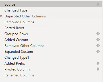

My current solution is creating new MMR Columns, then merging using the solution from this post then creating new MMR columns to check against birthdate and time between doses, and then comparing for stage 3.  Below is my current Mcode. (I do apologize, as I have several of these workbooks going as I try to figure this out, and the code does include the merged table, but it should give an idea.

After I mentioned it, thought I'd try out the merge + actual unpivot and it was actually more straightforward than I thought, so including here. Basically, we still figure out the MMR Status / MMR Date pairings and iterate through them with another List.Accumulate to dynamically do all the merges. And with our merge function, we extract dates when the status is "Given". Steps are the same as before once we get the unpivoted table.

MarkLaf
Similar to what some others have already suggested. This is still going off your original table and handling the "Given" filtering you want.
This is somewhat manually doing an unpivot action, with a separate treamtent on your two "date of measles" columns vs. the "mmr status" and "date of mmor" pairs. All steps below from Source to SortDates are performing this faux unpivot + filtering. Another way to do this (perhaps with better performance) would be to merge your status/date columns and then unpivot everything except ID and DOB, do your {birthday<, is "Given", not null} filtering, and then do a Group+Accumulate to filter our dates per the 24 day rule.
Source (note: added another row #13 to more directly test 24 day rule)
SortDates
The next steps, RemoveNullDates to ExpandValidDateRecords, then filter out dates before first birthday, group and filter our the dates that don't adhere to the 24 day rule, and then dynamically figure out the number of columns to expand.
Final table:
M code for adanced editor:

I believe you are looking for custom sort in a particular group i.e., remove nulls and sort the dates within a group.
If this is true, try this:
    Source = Table.FromRows(Json.Document(Binary.Decompress(Binary.FromText("dVJbDsQgCLzKxu9NELQKZ2l6/2usgLa02X6YwDjMjI99T5i+CQmoAwrLaD5hYQbisdFkssSb47snenB1FcBB6KaJq1ZymcimEE1lFesl2t0YgE0zkQnUgbApCj5DutHFYA+4DaACdqCcs1u+NKrS3FraqMdBzYlNR5HN70HENXUwBq/ngFHDcH+9JdZDCgQu/+FqzhJDz0b5YlpU13asG1BbKWPtujqN2W/c07bZnFbkQ8jPJijoS3SfsQcGsrpfMN/LMEv2XITr21U92ghSDC/LTaA+jI8f", BinaryEncoding.Base64), Compression.Deflate)), let _t = ((type nullable text) meta [Serialized.Text = true]) in type table [#"People Soft ID" = _t, #"Date of MMR vaccine 1" = _t, #"Date of MMR vaccine 2" = _t, #"Date of MMR vaccine 3" = _t, #"Date of MMR vaccine 4" = _t, #"Date of Measles vaccine 1" = _t, #"Date of Measles vaccine 2" = _t]),
    #"Changed Type" = Table.TransformColumnTypes(Source,{{"People Soft ID", Int64.Type}, {"Date of MMR vaccine 1", type date}, {"Date of MMR vaccine 2", type date}, {"Date of MMR vaccine 3", type date}, {"Date of MMR vaccine 4", type date}, {"Date of Measles vaccine 1", type date}, {"Date of Measles vaccine 2", type date}}),
    #"Unpivoted Other Columns" = Table.UnpivotOtherColumns(#"Changed Type", {"People Soft ID"}, "Attribute", "Value"),
    #"Removed Columns" = Table.RemoveColumns(#"Unpivoted Other Columns",{"Attribute"}),
    #"Sorted Rows" = Table.Sort(#"Removed Columns",{{"People Soft ID", Order.Ascending}, {"Value", Order.Ascending}}),
    #"Grouped Rows" = Table.Group(#"Sorted Rows", {"People Soft ID"}, {{"aalr", each _, type table [People Soft ID=nullable number, Value=date]}}),
    #"Added Custom" = Table.AddColumn(#"Grouped Rows", "Custom", each Table.AddIndexColumn([aalr], "Index", 1, 1, Int64.Type)),
    #"Removed Other Columns" = Table.SelectColumns(#"Added Custom",{"Custom"}),
    #"Expanded Custom" = Table.ExpandTableColumn(#"Removed Other Columns", "Custom", {"People Soft ID", "Value", "Index"}, {"Custom.People Soft ID", "Custom.Value", "Custom.Index"}),
    #"Changed Type1" = Table.TransformColumnTypes(#"Expanded Custom",{{"Custom.People Soft ID", Int64.Type}, {"Custom.Value", type date}, {"Custom.Index", type text}}),
    #"Added Prefix" = Table.TransformColumns(#"Changed Type1", {{"Custom.Index", each "MMR " & Text.From(_, "en-US"), type text}}),
    #"Pivoted Column" = Table.Pivot(#"Added Prefix", List.Distinct(#"Added Prefix"[Custom.Index]), "Custom.Index", "Custom.Value"),
    #"Renamed Columns" = Table.RenameColumns(#"Pivoted Column",{{"Custom.People Soft ID", "People Soft ID"}})
    #"Renamed Columns"
Note: If this is what you want, then you can find the optimizing ways based on your data. Like doing the pivot inside the group itself or some other ways. Let us get the basic output you need first!

If you dont want duplicates, add the step in between Sorted Rows and Grouped Rows
    #"Removed Duplicates" = Table.Distinct(#"Sorted Rows"),
    #"Grouped Rows" = Table.Group(#"Removed Duplicates", {"People Soft ID"}, {{"aalr", each _, type table [People Soft ID=nullable number, Value=date]}}),
Then the outputput will be
Thank you @sevenhills ,
I  added in the step for removing duplicates, and while that worked, the sort didn't work regardless if the removing duplicate step was included, or was before or after the sort step.
The co pilot option is there right beside the search bar in microsoft edge, it is available to everyone:
I have added my own comments after the # in the steps
// Sample list of dates
Dates = {#date(2023, 1, 1), null, #date(2023, 1, 15), #date(2023, 2, 1), #date(2023, 2, 10), #date(2023, 3, 5)},
// Step 1: Remove nulls
NonNullDates = List.RemoveNulls(Dates), #make sure that using this step doesn't affects the applied steps later
// Step 2: Sort chronologically
SortedDates = List.Sort(NonNullDates # since the last step name in this case is NonNullDates, Order.Ascending),
// Step 3: Filter dates with a nested List.Select
Result = List.Accumulate(SortedDates # you need to ensure that over here you put the last applied step name and not sorted Dates, {}, (accumulator, currentDate) =>
if List.IsEmpty(accumulator) or Duration.Days(currentDate - List.Last(accumulator)) >= 24
then accumulator & {currentDate}
else accumulator
Result # this is the name of the last applied step
