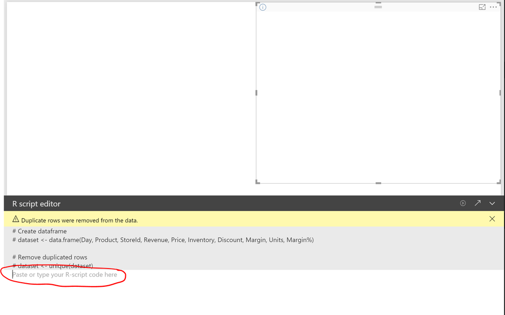

  5. Once I’m happy with the data input (this will be the raw data that R receives) I convert the visual to an R visual by selecting the visual in the canvas and then clicking on the R visualization icon
  6. Add the script using the R script* editor (visible when you select the R visual directly in the canvas). Note, you may have to expand it by clicking on the far-right arrow in the R script editor menu below the canvas.
  7. Once expanded you should see the below, with space for the R script.
    Copy/paste the script below into the script editor (any line that starts with # or ## is a comment only and is not executed):
    ## Use the corrplot library for the cor() function which calculates correlations and has the corrplot() function to visualize the output
    library(corrplot)
    ## Get rid of the first three columns in dataset since they, in this example, contain categorical values
    dataset <- dataset[,-1:-3]
    ## Calculate correlations between the remaining columns
    m <- cor(dataset)
    ## Plot the result with a light gray background color
    corrplot.mixed(m, bg="light gray")
  8. Use the first arrow in the R script editor to manually execute the script (any change/interaction with the report will also cause the script to be rerun.
