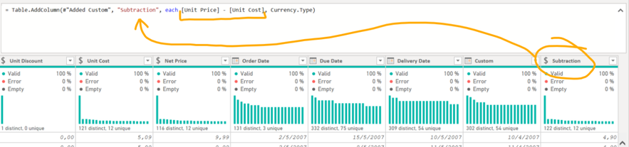

Similar to the previous one of a new custom column, most actions under the "Add Column" tab usually have a way to change their name. An example of auto-generated steps such as a two-column "Subtraction":
As we can see there we could quietly replace in the code the text "Substraction" that was generated automatically by the desired name instead of generating a new step.
