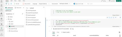

Connecting and pinning Lakehouse to the Notebook
I have a scheduled notebook running on daily basis which is connected with Lakehouse for reading input parquet files and writing output as Tables. These tables are connected with Power BI report and semantic model. Now my daily schduled script is failing because pinned Lakehouse to the Notebook  is getting disconnected and I need to add the lakehouse everyday manually and re-run the script. May I know workaround for this issue?

If you clone the notebook and then pin the lakehouse to the cloned notebook, does the same happen?

I tried with sample data by pinning the lakehouse and loading as table with a new notebook shedules are successful.
I have issue with my daily scheduled notebooks.

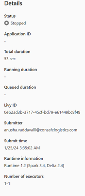

If I made another copy and schedule the new notebook its worked at first time. Thanks for the tip. But second time schedule is successful but script did not ran. As below showing the monitor hub first run is successful at 2:23AM showing in the first screen shot and next runs are showing succeeded but check the setting details in the second screenshot below.
Notebook is not really running the script. Does that mean am I am ran out of ran capacity or what would be the reason behind?

Thanks for the reply. Yes, I have checked in the same way, and see the below screenshot. The server is not getting started. If I run manually by going into the notebook it works but if I try to schedule server is not picked up. Please check the below screenshot
