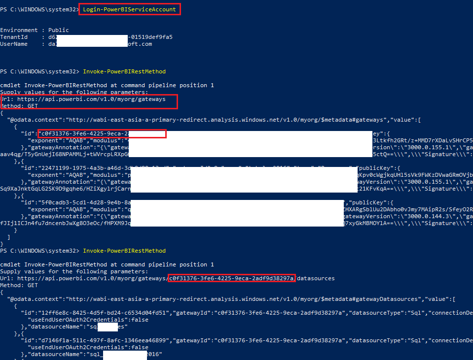

Hi Sam,
Since you have known the APIs and the PowerShell tool very well, I would suggest you check your account permission. Even the Global Admin can't access everything. You can log in to the PBI Service to see what you can see. Please refer to the snapshot below. It's easy and clear.

Hi @SamTrexler,
The cause isn't the permission. You definitely have the permission to get your gateways. I tried the same as yours and I got the expected result.
Can you check if you have any gateways installed? Please refer to the snapshot below.
Dale
