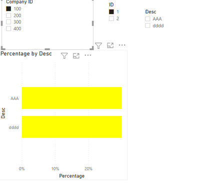

Conditional color coding in Bar chart
- Anonymous5 years ago
Hi Kavya123
This issue should be caused by Max function in color measure, it will always catch the max Company ID in same Desc. So when you have 100 and 200 in AAA(Desc) in 1(ID), only click 200 will show red. Try values function to get Company ID in Data Table. The new measure is as below.
Color Measure 1 = VAR _SELECTCompanyID = SELECTEDVALUE('Company ID'[Company ID]) VAR _VALUES= VALUES('New Table'[Company ID]) RETURN IF(_SELECTCompanyID IN _VALUES,"Red","Yellow")Result is as below.

Hi Kavya123
I think you need to build an unrelated Company ID table to create the slicer to achieve your goal. If you use Company ID column in the same table, your color measure will disable, due to all Company IDs are selected all the same.
Unrelated Company ID table:
Company ID =
VALUES('Table'[Company ID])
Measure is as below.
Color Measure =
IF(MAX('Table'[Company ID]) = _SELECTCompanyID,"Red","Yellow")
Find Data color in Format, click fx, format by field value and select this color measure.
Result is as below.

- Kavya1235 years ago
Helper III
Hi Ricozhou,Thanks for your response. In my case few descriptions are repeating. It is working for Company Id 200 and for company ID 100 color is not changing.Company ID , ID, Desc
100,1,AAA
200,1,AAA
300,1,DDD
400,1,DDD
100,2,EEE
200,2,FFF
300,2,GGG
- Anonymous5 years agoNot applicable
Hi Kavya123
Rico ZhouIf this post helps, then please consider Accept it as the solution to help the other members find it more quickly.
Helper III
Thanks a lot. It worked
