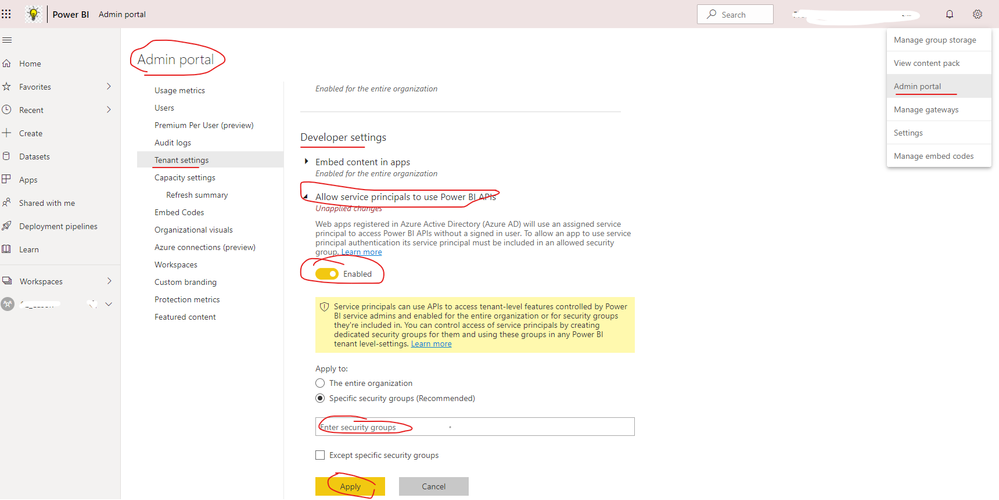

Hi @soldous ,
Sorry for delay. Could you please check whether you complete the following settings?
1. Allow service principals to use Power BI APIs in Admin portal
2. Add the related service principal as admin in the workspace which the report located in
If it still not working after set the above settings, please use this link to test it and provide me the request body for later troubleshooting. Thank you.
