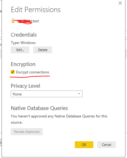

Binway,
Have you configured SSL encryption for your SQL Server instance? If SSL encription is configured properly in your data source, you can go to File->Options and Settings -> Data Source Settings in Power BI Desktop, select your SQL data source and tick "Encrypt connections".
Lydia
