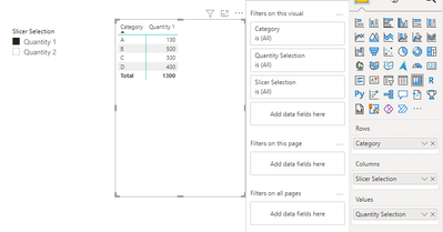

Hi MFelix,
Nice solution!
Is it also possible to do this in a table? If I change your chart into a table, the column is blank after making one selection, but I want to hide the column completely.
I hope you can help me with this one.
Thanks, Halmar
Hi @Anonymous ,
Yes this option can also be used with a table or matrix visualization, if you use the matrix visualization you can use the single measure and the disconnected table on the columns if you are using a table you can use any of the two options.
Be aware that since you are using a table visualization depending on your calculation you may need to make some adjustments so the the totals ar e correct, if it's a simple sum no need but if there is anyt complex calculation that may be necessary.
Regards
Miguel Félix
Hi @MFelix ,
Ok, but I tried to do that with a normal table, but still the empty column is visible.
What am I missing?
Thanks, Halmar
Hi @Anonymous ,
You are correct, sorry for the misseleading, in this case use the matrix visualization:
Just remember to turn off subtotals on columns
Regards
Miguel Félix
