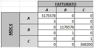

this is what i would like as a result of my pivot
(the first sub-row is the amount of "Ricavi Tot" and the second sub-row is the counting)

In power query, create two columns named Valutazione_MDC_BI, Valutazione_Ric_BI:
Perform a group by operation by these two new columns and calculate their sum Ricavi Tot and count.
Exit and save the data to use the matrix object in power bi desktop.
At this time sum and count are displayed side by side instead of above and below, if you want to display above and below, you can turn on the following option.
The final visual effect is shown below:
The pbix file is attached.
If you have any other questions please feel free to contact me.
Yang
Community Support Team
If there is any post helps, then please consider Accept it as the solution  to help the other members find it more quickly.
If I misunderstand your needs or you still have problems on it, please feel free to let us know. Thanks a lot!

@Alberto95 - to create a calulated column, select the table in the "Data" tab and then select "New Column" from the toolbar. Paste your measure DAX into the new formula area that appears.
You can then use a Matrix visual with both new columns in columns and rows, and your measures for the amount of "Ricavi Tot" and the counting (use COUNTROWS( 'Table' ) for this) in the Values section.
The will appear side-by-side rather than above and below. But it is the closest you will get to you desired visual.
