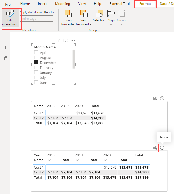

Hello @CLCastroEn ,
Select the slicer on the report page, and then go to the Format tab on the top ribbon. Select Edit Interactions and choose to turn off interaction with the chart that you want to remain static.

Select the slicer, and then under Format, turn on Edit Interactions and set the chart on the left to none.
