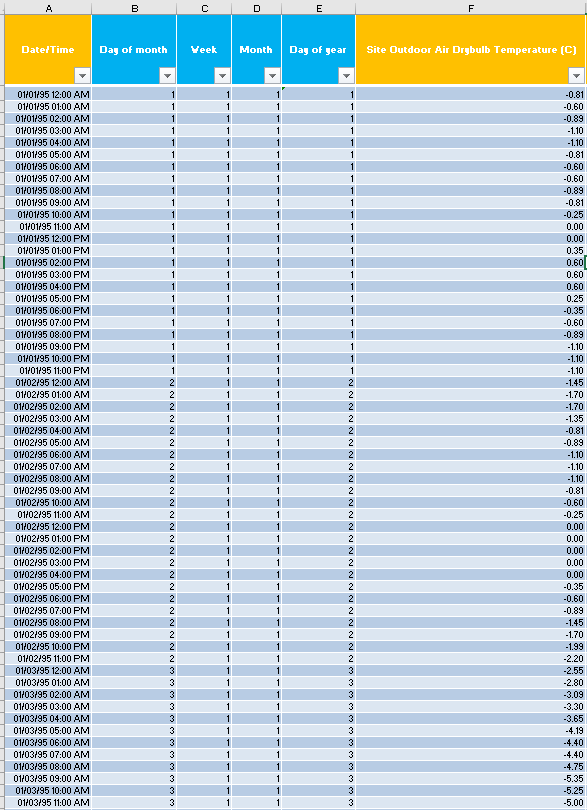

I am attempting to re-create a chart that I have previously made in excel in powerBI. In excell i simply used conditional formatting to change the color of each cell according to the size of the data value in that cell. Therefore before I spend too much time pulling my hair out trying to figure this out I was wondering if anyone had 1. A recommendation for a custom visual to use, 2. A recommendation for using conditional formatting within powerBI
Anything helps, thanks!!

So I have gotten this far with the conditional formatting!  But I would like to, if possible, not aggregate the total monthly data but instead have each day for each month on the top x-axis and have not been able to arrange that yet.

YES I totally forgot to attach a picture! ....lmk if you need better photos!
final outcomefinal outcomeDatasetDataset
I kind of broke my cardinal rule about asking people to supply text data that can be copied because I was interested in this. Seems like you can create this via a blank column and a conditional formatting based upon a measure. See attached PBIX. This is my working copy as I solve problems on the forum so it has a bunch of stuff you don't want. Look at Page 6 and Table 15.
