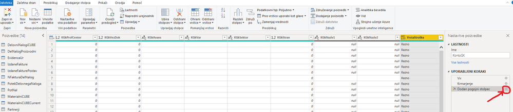

I am just wondering if there's a way to edit calculated/measured field in PowerBI?
For everyone still having problem with this here is the solution to edit calculated column the same as you created it and not in the formula bar.
My Power BI is in Slovenian language, but dont let this bother you. When in query, choose the right table and select your calculated column, then click on the wheel icon usually representing "options" (see attached photo).
Hope this solves your problems, it certainly did mine.
Kind regards
Jernej
