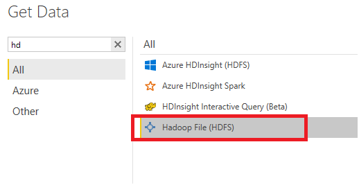

I have also tried to use Power BI's Hadoop connector but can't get this to work either (it just asks for the server in the first instance and fails at that point if I give the Knox server).

1. I would suggest you call the REST API directly to check if the Knox causes this issue. Just for test.
2. Did you try the Hadoop connector? Please refer to https://www.youtube.com/watch?v=v-meEu9BRkA.

I will watch the video on how to use the Hadoop connector, my first experience was that it was not intuitive, the server they ask for could be one of a few types as there are different ways to connect to Hadoop and ask for data, we just happen to use Knox
