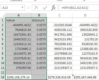

What is NPV and how would you calculate it normally if you weren't using Power BI?
- 104731Frequent Visitor
Thanks for the reply
NPV in excel is Net present value calculation as shown in the image below.
But That is not working for me when I try to calculate in Power BI
- AnonymousNot applicable
Looking at Excel there are 2 NPV calculations and dax only seems to have the XNPV version. When i use XNPV in Excel and PowerBI i get the same result. You could probably write a Dax measure to do that, but i don't understand the Math formula well enough to get it right. I gave it a quick try but the Pure Math side of what the Wiki was talking about was beyond me.
