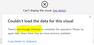

I created the 2 measures you provided.
However, when adding either of them to the existing table visual, PBI returns this error:
“…not enough memory to complete this operation…”
After looking at several sites on this PBI error, I checked the following things:
NOTE: Screenshots are provided for each item below.
The report has not had memory issues up to this point that I have seen.
Let me know if you have any suggestions.
Thanks again for your help.
Hi, @WinterMist ;
check how much RAM and CPU power BI is taking. Sometimes web browsers take a lot of memory. So please check and close any applications taking a lot of memory.
Save changes in power BI too and close and open the file again and try.
It may be caused by the data model being too bloated if there are no other services occupying hardware resources. For example, the data table is too large, or there are too many queries...
In addition, the local machine configuration is too low, which is also a problem.
Try to refer to the links.
https://radacad.com/performance-tip-for-power-bi-enable-load-sucks-memory-up
Community Support Team _ Yalan Wu
Hello v-yalanwu-msft
Thanks for your response.
ADDITIONAL NOTES:
Thanks again for your time.
Additional Notes:
1) The "XL Comm Rates" data table only has 33 rows. If I create a visual table of only "XL Comm Rates" and add the 2 new measures, it works. There is no memory error.
2) However, "XL Comm Rates" table joins to the "D Plan" table (Plan Dimension) on the Plan field, and then from "D Plan" table back to the Facts table.
3) The visual table where these 2 new measures need to be added is extremely large, as it contains data from Facts, and almost all dimensions. For each row, it should lookup the "Plan" in the "XL Comm Rates" table to determine if the record is capped (Y/N) and then perform the calculations. But of course, this is the visual table which produces the "not enough memory" error when attempting to add either measure.
These notes should at least tell you that your measures are working correctly.
Unfortunately, I just can't figure out how to use them in the visual table where business needs them yet.
