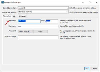

I was able to connect following these steps :
Inside Power BI, after Get Data > Database Mysql on the server field (Figure 1), i used the "hostname" given from the server on the mysql (Figure 2)
After it, i went to this screen which asked for the name of the server and the password.
Then it worked.
