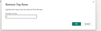

So I'm hoping somebody can also tell me what I'm missing here, before I import a spreadsheet to work with I gather the data can be transformed but I can't see how to remove multiple rows.  Like, I don't want rows 1-10 but can't see how to take them away in one go.

Hello, @Bankesy26-_ ,
once you load your file,  go to Remove Rows and then write the number:
vojtechsima_0-1731064718689.pngvojtechsima_1-1731064725870.pngvojtechsima_2-1731064729462.png

Hi @Bankesy26-_
In home tab there are options to remove/skip/keep rows
Beyond what is available from the GUI, I would create conditional/custom column to that will determine whether a rows is to be kept or not based on certain conditions. This column is to be used to filter the table.
