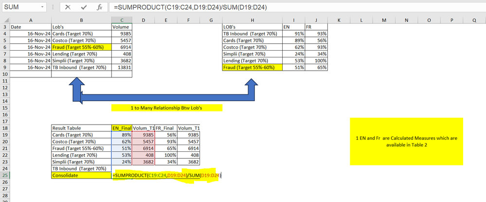

I am trying to replaicate one of the SUMPRODUCT calculation in power bi dekstop.
I have two tables Table 1 and Table 2 . In Table 2 i have 3 columns Overall, EN abd Fr which are calculated measures created based on calculations.
So my requirement is now We need to do Sumproduct of these columns with Volume (column)present in Table 1 .
Please see below screenshot and attached excel for better understandig:
Formula for EN=
EN_ = DIVIDE(
SUMX(FILTER('VQ''s',CONTAINSSTRINGEXACT('VQ''s'[VQ's],"EN")),
'VQ''s'[SL%]*'VQ''s'[CaLL_Answered]),SUMX(FILTER('VQ''s',CONTAINSSTRINGEXACT('VQ''s'[VQ's],"EN")),'VQ''s'[CaLL_Answered]),0)
FR_ = ROUND(DIVIDE(
SUMX(FILTER('VQ''s',CONTAINSSTRINGEXACT('VQ''s'[VQ's],"FR")),
'VQ''s'[SL%]*'VQ''s'[CaLL_Answered]),SUMX(FILTER('VQ''s',CONTAINSSTRINGEXACT('VQ''s'[VQ's],"FR")),'VQ''s'[CaLL_Answered]),0),2)
Need to create SuMproduct(EN * Volume)/Sum(Volume) for Final Table:
Request to please help me in creating this .
Thanks,
Ash

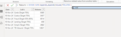

Hi @Anonymous
To replicate the `SUMPRODUCT` calculation from the screenshot in Power BI using your tables, follow these steps:
1. Understand the Requirement:
- Inputs:
- `Volume` column from Table 1.
- Calculated measures (`EN` and `FR`) from Table 2.
- Formula:
SUMPRODUCT(EN * Volume) / SUM(Volume)
- This means you want to multiply `Volume` by `EN` (or `FR`), sum the products, and divide by the sum of `Volume`.
2. Steps in Power BI:
Step 1: Ensure Relationships Exist
- Confirm that Table 1 and Table 2 are connected by a relationship using the `LOB` column (as shown in the screenshot). Ensure the relationship is one-to-many, with Table 1 on the "many" side.
Step 2: Create Measures
For EN Final Measure:
This measure calculates the weighted average using `EN`:
DAX
EN_Final =
DIVIDE(
SUMX(
'Table 1',
'Table 1'[Volume] * RELATED('Table 2'[EN])
SUM('Table 1'[Volume]),
0
For FR Final Measure:
This measure calculates the weighted average using `FR`:
DAX
FR_Final =
DIVIDE(
SUMX(
'Table 1',
'Table 1'[Volume] * RELATED('Table 2'[FR])
0
3. Explanation of DAX Logic:
1. `SUMX`:
Iterates through each row in `Table 1`, multiplying `Volume` by the corresponding value of `EN` or `FR` from `Table 2`.
2. `RELATED`:
Fetches the matching `EN` or `FR` value from Table 2 using the relationship.
3. `DIVIDE`:
Divides the weighted sum of `EN` (or `FR`) by the total `Volume` to calculate the weighted average. The third argument (`0`) handles division by zero gracefully.
4. Result Table in Power BI:
To display the results:
- Add a table visual.
- Include the `LOB` column from Table 1 and the newly created measures (`EN_Final` and `FR_Final`).
Please mark this as solution if it helps. Appreciate Kudos.
If you need further help implementing this or have additional requirements, let me know! 😊
Hi @FarhanJeelani ,
Thank you for this explanation.
I am trying to create the same formula but it snot picking up the Related Table .(Table 1 is connected with Table 2 where table 2 is of Many side and Table1 is at 1 side)
Please let me know where i am doing wrong ?
Thanks,
Ash
