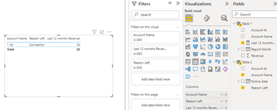

Hi @fazza1991 ,
According to your description, here are my steps you can follow as a solution.
(1)My test data is the same as yours.
(2) We can create  a measure.
Last 12 months Revenue =
    SUM ( 'Table 1'[Revenue] ),
    FILTER (
        'Table 1',
        [Report Month] >= EOMONTH ( MAX ( 'Table 2'[Notice date] ), -12 )
            && [Report Month] <= MAX ( 'Table 2'[Notice date] )
(3)Then the result is as follows.
Neeko Tang
If this post helps, then please consider Accept it as the solution to help the other members find it more quickly.
