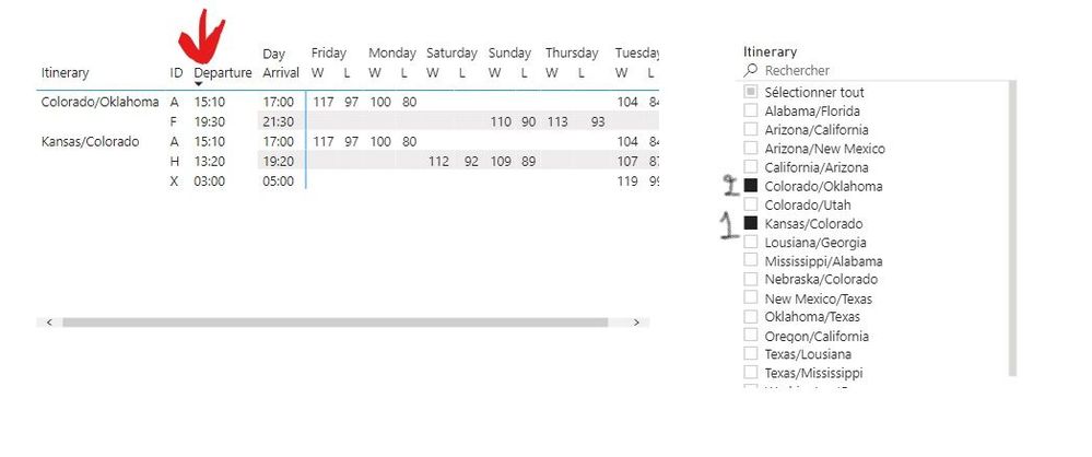

- elois333 years agoHelper I
Thank you v-xiaotang and Ashish_Mathur
I wanted to share with you the dashbord but it says that the file type pbix is not supported, so Iam attaching a screenshot. ๐
-You have a matrice table with departure/arrival hours, weight/lenght of cargo, days, ID mission and itinerary. You have also a slicer which allows my colleuges seach for the itinerary they need.
-I'm trying to sort my matrice table by the departure time, so when I have more than one mission for the same itinerary I will have all the missions starting from the earlier one.
-The second thing that I was asked to do and I'm struggling is to sort my table based on the order of the selected value on the slicer. For example when I search for Kansas/Colorado and Colorado/Oklahoma I want my matrice table to have that specific order and not put the itineraries by default in alphabitical order. I have a lot of missions and itineraries and the order of the itineraries is based on my colleuges needs. ๐ I know that maybe with "selected value" I could make things work, what do you think?
Thank you very much for your time and help, it's much appreciated
Kind regards,
Elois

- Ashish_Mathur3 years agoSuper User
Sharing a screenshot does not help at all. Share a dataset to work with (a table that can be pasted in MS Excel) and on that data, show the expected result.
