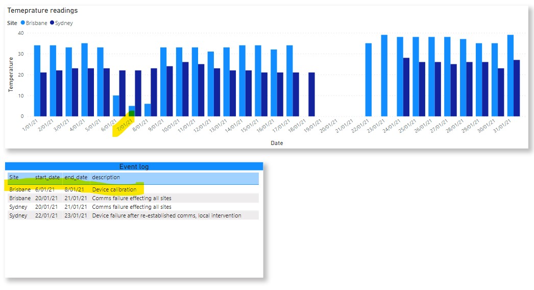

I am looking for a solution not to calculate but to show all entries of a table that have an start date before and an end date after a selected date.
I have created a simple example as per screenshot and PBIX file below:
http://roggenmoor.de/PowerBi/DashboardScreenshot.jpg
http://roggenmoor.de/PowerBi/filter_twodatecolumns.pbix
In that example I would like to select the 07/01 and want to have the event starting on the 6/01 and ending on the 08/01 shown in the table below.
Thanks for your help
BR
Andreas

Hi, @Anonymous
Please correct me if I wrongly understood your question.
I have attached the sample pbix file's link down below.
I made an inactive relationship for both the start date and the end ate - date table.
I created the measure like below, and inserted into the visual filter.
truefalse measure =
COUNTROWS ( event ),
FILTER (
event,
event[start_date] <= SELECTEDVALUE ( 'date'[Date] )
&& event[end_date] >= SELECTEDVALUE ( 'date'[Date] )
https://www.dropbox.com/s/1aubishhz9w5n23/filter_twodatecolumns.pbix?dl=0

Hi Jihwan,
That looks pretty good. Thank you so much.
