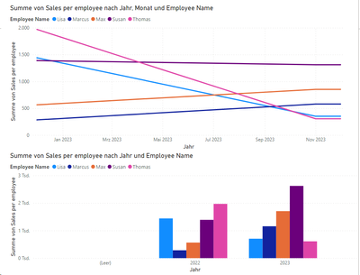

But if I now want to visualize the sales per employee in a visual I'm not able to show the allocated sales in relation to the invoice date (e.g. line graph showing development of sales over the year).

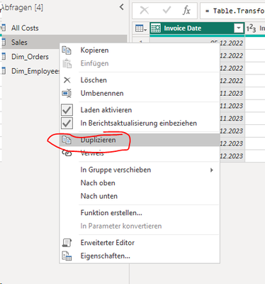

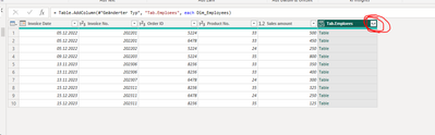

I dublicated the table sales. The new table was named sales_splitup. I added the table Dim-Employees as column to table "Sales_splitup". Than I expanded the additional table within the added column.
This resulted in a "Sales_splitup"-table with 5 times more lines. Each Sales Line was 5-times multiplied for each employee.

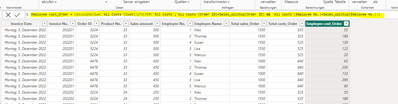

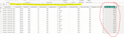

This made it possible to calculate the sales-split employee-wise in the sales_splitup table.
Find the screenshots of my doing as follows:
And at last the result:
This made me able to create following visual:
