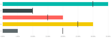

Set multiple target lines for a bar graph
Hi all, instead of showing one Target Line for all categories, I would like to set one Target Line for every bar (category) in a bar chart, as example below. Every small line indicates the target sales for every Product.
Hopefully I can achieve that and show in my report. Thank you!

  • Hi Benkee
    Maybe this a bit old now but you could utilise the Bullet chart to something like this
    bullet chart
    You would need to add it from the PowerBI Marketplace (free)
    The line values are the "Values" and the target lines are the "Target Value"

      Hi, thank you for the reply. I believe that you are actually referring to this:
      However, I am still hope that I can achieve the same result with the target lines as I might have many categories to show on x-axis.

    Hi Anonymous
    Here is a bar chart with multiple target lines, which will help you to find the target and actual value differences.
    Multiple Target lines for bar chart. PBIVizEdit.comMultiple Target lines for bar chart. PBIVizEdit.com
    Download link for the custom visual file on this page,
    https://pbivizedit.com/gallery/bar-chart-with-multiple-target-lines
