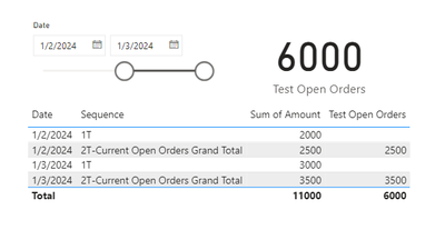

When i try to add the date slicer it just blanks all the cards to 2 dashes and my other donut chart to empty
Attached is a screen shot of my report and its relationships

Hi @westman ,
Based on your description, I created the following test data
Datestbl
MTDSalestbl
Relationship
You could try changing ALLSELECTED ( 'Datestbl'[Date] ) to ALL( 'Datestbl'[Date] )

Thank you for replying Albert, i made your suggestion change of ALL vs ALLSELECTED.  However, there was no change in the output into the card visual.  Same 2 dashed lines.
I am wondering if using a Min Date and Max date as a VAR in the measure may be more accurate way to write the measure instead of using FILTER.  What are your thoughts?
Hi @westman ,
Thank you for your reply, the above dax function is based on the sample data I created, you can try to use the maximum date or minimum date as the filter condition, if you want more accurate help, please provide the detailed sample data and hide the sensitive information.
Best regards,
Albert He
westman
Side note: The measures  Current Open Orders and SalesPeriodT work if I  remove the date slicer, only adding the date slicer does it result in the picture above
