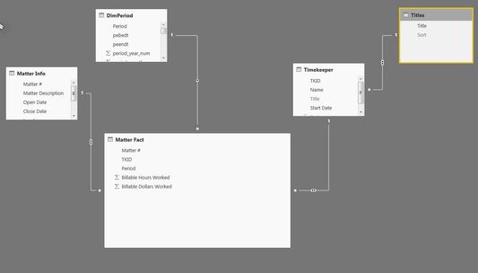

I have a fairly straightforward requirement that I can't seem to crack. Here's the situation:
Data model
Fact
Visual
DimMatterInfo (Matter # is primary key)
DimTimekeeper (TKID is primary key)
DimTitle (Title is primary key)

I've tried the following formula, but it's returning 6 rows (the correct answer should be 3). Obviously I need to filter to only show "Analyst" which comes from a related table. I guess at this point I'm not sure if I need to modify the SUMMARIZE statement or somehow filter using a RELATED function?
Analyst # of Matters =
VAR TempTable =
FILTER(
SUMMARIZE('Matter Fact',
'Matter Fact'[Matter #],
"Total Hours Worked", SUM( 'Matter Fact'[Billable Hours Worked] )
[Total Hours Worked] > 20
COUNTROWS(TempTable)
