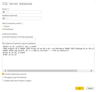

Hi @Hussard,
I think you've connected to 3 tables via DirectQuery and you want to create a new 4 table in Power BI, which will be a result of joining of these 3 tables?
Why you simply not connect to a database with specifying your entire query in Advanced options -> SQL statement like below?
dqdq
Ruslan
Hussard
Yes, you are right, this is exactly what I want to do !
Yes I found here this solution (it's ok) but I wanted to use the merge fonction and count to have a clearer view of Power BI.
I don't know if it's possible but your solution is good and works
Sébastien
