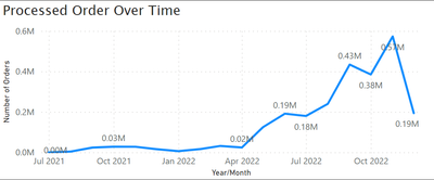

Hello All,
I currently have the following data in table form. I need to have the monthly totals as a rolling total and visualize it.  Eg: August would show 23+3569 and September will show 23+3569+23687.
Current Visual
Expected visual (example)
Thank you in advance
