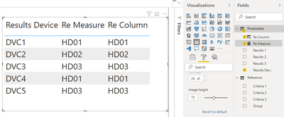

Result:

Result:
Allan
@v-alq-msft that works perfectly, thank you!
