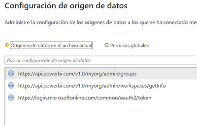

Hello @Syndicate_Admin ,
The application had already created it and now when modifying the permissions, it already allows me to obtain the token, but it still gives me problems:
Formula.Firewall: Query 'Invoked Function' ('Source' step) is gaining access to data sources with privacy levels that cannot be used together. Regenerate this combination of data.
I think the problem is in those functions in which the origin is constructed with the result of a previous function, for example:
https://api.powerbi.com/v1.0/myorg/admin/workspaces/scanStatus/" & PostWorkspaceInfo()
This source does not appear to me in:
So I can't change the level of privacy.
Is there a way to define it in those cases?
