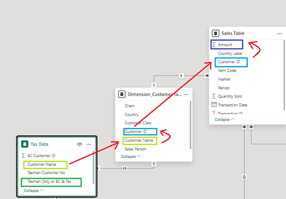

I have data that I've had to split between Business Central Only and Tasmanian data that's in Business Central and I created two new tables that I've added into a PB file that has already existing tables including the Sales table which has the transactional data.
The BC only data has its own customer code and the BC and Tasman data have different customer codes.
I've the relationships set and they seem to work correctly.
Here are the relationships I created below with the new tables:
When I pull the Tasman Customer number from the Tasman Data table and the Customer description from the Customer table and the Amount from the sales table, the BC and Tasman customer data is correct but for the BC ONLY data it should be blank but it's pulling in data for only one customer (Arbour and 117) for all the Tasman Only Customers when they should be blank as they have no data that's in the customer or sales table as they came from a seperate file.

According to the test data you provided in your second reply, I found the possible problem:It may still be due to the wrong data in the data source, which leads to the final Amount will show the results
Here is my test (check the process: you can also try similar steps to find out)
Here is the test file you provided
The tables where I think there are data problems are in these tables
The filtering relationship between them is as follows:
When Customer ID = 27, if in accordance with the requirements of the Tas Data table at this time in the field Tasman Only or BC & Tas = “TO”, then the Amount should be filtered, the three lines of data are blank, in this case, sum(Amount) The result of the calculation is blank, but in fact, according to the data you can provide to see, finally filtered out the three rows of data is not empty (100,48,350) so the final in the visual presentation of the results of the calculation sum of amount = 100 + 48 + 350 = 498
like this.
So I think there is something wrong with your original data, you can replace the original sum of Amount by creating  measure
like this.
