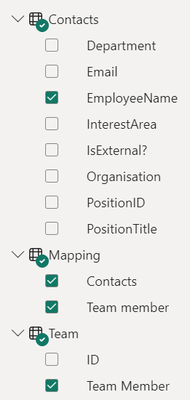

      How do you get it so that it will display what's on the example? I created a database with three tables:
      1. Table that lists all my team members
      2. Table that lists all the stakeholders we have
      3. Table that maps which team members talk to which stakeholders.
      Basically like this:
      Who do I put in as Parent ID, Id, Measure and Values?
      In my scenario, I would have team members talking to the same people, so I think this is why when I tried using the decomp tree (my first thought), it didn't seem to work at all.
