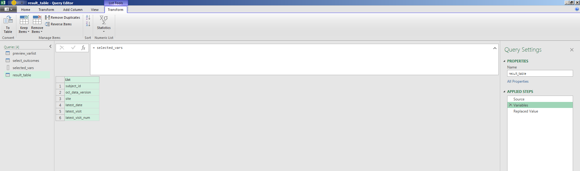

These are the variables currently selected in selected_vars:

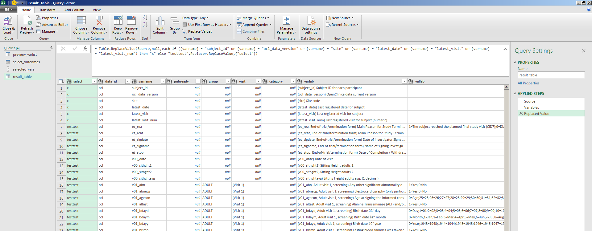

And this is proof of a working example with manually selected values for [varname]:
