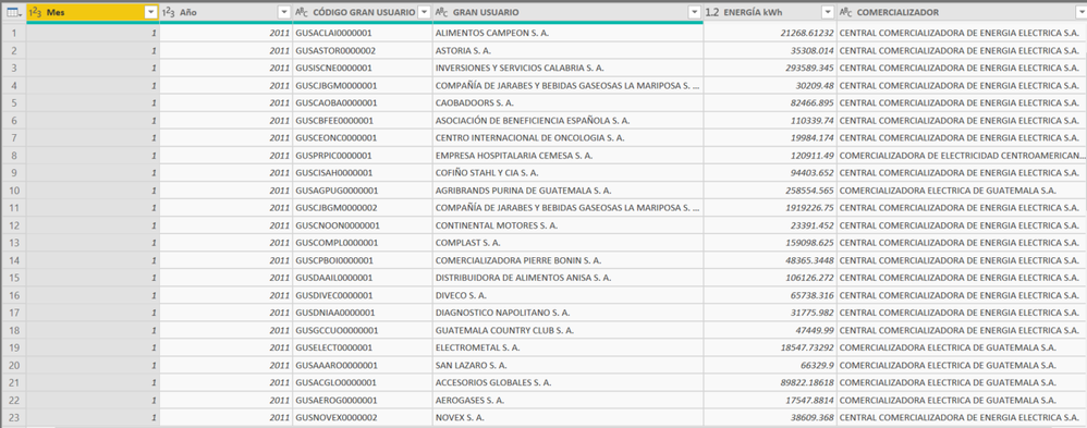

About the data input, I transformed and combined several Excel documents (using power query) that have the following structure:
Hope this gives a bit more information

Following, a screenshot of the table before the python step:Captura.PNG
