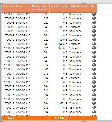

When I try to put more than 3 conditions for my table, this defaults to always the same icon. However, if I only leave 3 conditions, it does work.

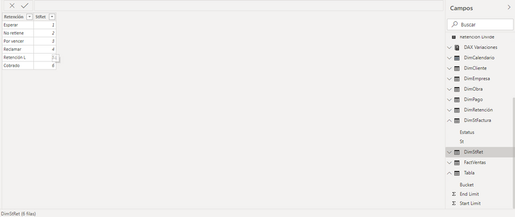

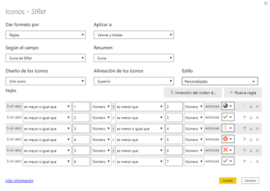

The formats and tables are:
Hi, @Anonymous
I'd like to suggest you check if other columns with number data type in the visual are set as 'Don't Summarize'. You may set them as 'Don't Summarize' to see if it works.
Allan
If this post helps,then consider Accepting it as the solution to help other members find it faster.
First off your from 3 to 4 says less then or equal to 4 so that is not correct
Second you are doing a sum. My guess the sum is greater then 7 and thus it will pick the first icon.
