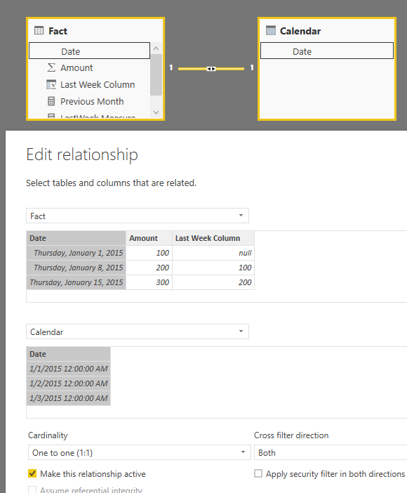

The DATEADD() function only works for contiguous date selection, which means you need to select contiguous dates into your table visual. In this scenario, you can create a calculated column instead of a measure to workaround this issue.
For PREVIOUSMONTH() function, it should work once you create a relationship between your fact table and the full calendar table.
See my sample below:
Previous Month = CALCULATE(SUM('Fact'[Amount]),PREVIOUSMONTH('Calendar'[Date]))
Last Week Column = CALCULATE(SUM('Fact'[Amount]),DATEADD('Calendar'[Date],-7,DAY))
