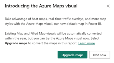

Regarding the Azure Maps visual update, when you create an Azure Maps visual in Power BI Desktop, if it is old, the following dialog box will be displayed prompting for an update:

Hi Jarvis,
I don't get that error message, so I suppose Azure Maps is up to date.
