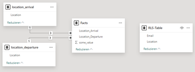

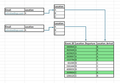

In my data model, I have a fact table in which location is used in two ways - let's say location_departure and location_arrival. I have a separate dimension table containing all the location values. Since I need to filter/interact with the fact table using location across both fields and can't have two active relationships, and because this dimension table is relatively small, I copied it using Reference in Power Query, so now have two identical tables that can filter on location_departure and location_arrival, respectively. So far so good, and this works beautifully for a user with access to all the data.
However, I need RLS to restrict users to only allowable locations. So I've added a role using USERPRINCIPALNAME() that checks for the user in each of the the location_departure dimension table and location_arrival table. That works too so far.

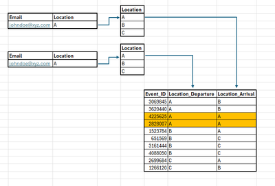

The issue becomes how that RLS is filtering the fact table. I need users to have access to records in the fact table when the user's location value matches either location_departure OR location_arrival. Here's what I'd like a user to have access to:
But the way it's working now, it's applying both filters to the fact table so that the only records available to the user are those where both the location_departure and location_arrival values are the same:
I understand what's happening, but I can't figure out a way around this issue. Any help or thoughts on a different approach?
Thank you for any insights.

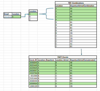

Hi, @jmunn

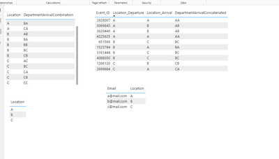

Based on the image you showed at the end, I've created a simple data set:

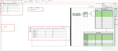

My relationship is as follows:

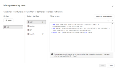

I created an RLS role as follows:
FACT Table DAX:
VAR _user_location = MAXX(FILTER('UserInfo','UserInfo'[Email] = USERPRINCIPALNAME()),'UserInfo'[Location])
VAR _table = SELECTCOLUMNS(CALCULATETABLE('REF',FILTER('REF','REF'[Location] = _user_location)),'REF'[DepartmentArrivalCombination])
RETURN 'FACT'[DepartmentArrivalConcatenated] IN _table
Be able to get the results you expect:
I've uploaded the PBIX file I used this time below.

Hi @jmunn ,
in the usual approach to set up a star schema, the fact table would not filter the dimension tables.
You can test using a bidrectional relationship betwenn the fact table and the two dimension tables. Make sure to check "enable security filter in both directions" in the relationship settings.
Then users would only see dimension values which are relevant for them. I am not sure about performance penalties in this approach. That's something you'd need to test.

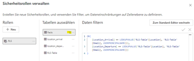

Hi @jmunn ,
if RLS does not need to apply to dimensions (users may see all dimension values) you could use a much simpler approach.
  1. Disconnect the RLS table from both dimension tables
  2. Update the RLS statement using the advanced editor and filter directly on the fact table
  3. use a statement like this for RLS:
OR (
    [Location_Arrival]
        == LOOKUPVALUE ( 'RLS-Table'[Location], 'RLS-Table'[Email], USERPRINCIPALNAME () ),
    [Location_Departure]
If multiple locations can be assigned to single users, the DAX statement would look something like this:
FACT Table DAX:
Create a reference table that lists all combinations in your fact table for departure and arrival.
Create another reference table with all locations.
Control the locations table from the RLS.
Control the combinations table from the locations table
Control the fact table from the combinations table.
