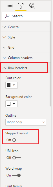

Hi Narukkp ,
You can implement it using a matrix.
Drag the column to the Fields -- > turn off the option of Stepped layout -- > turn off the option of Row subtotals -- > expend all down one value in the hierarchy

Hi Xue Ding,
I have tried your instructions (Off 'Stepped layout', Off 'Row Subtotal' and Click on 'At the lowest level of data') but the result shows only 1 row (instead of 4 rows as in the below images).
Please help to check.
Thank you so much.
