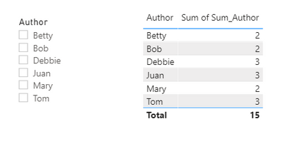

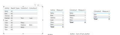

Don't @S2,
According to your requirements, I tried one of the simplest methods, which can be used as a reference: create three measures to count the number of Author, CoAuthor1, and CoAuthor2 columns. Create another table and accumulate the obtained number.
Measure1 =
CALCULATE(
    DISTINCTCOUNT('Table'[Report Types]),
    ALLEXCEPT('Table', 'Table'[Author])
Measure 2 =
CALCULATE(
    ALLEXCEPT('Table', 'Table'[CoAuthor1]),
    FILTER( 'Table', [CoAuthor1] <> BLANK() )
Measure 3 =
CALCULATE(
    ALLEXCEPT('Table', 'Table'[CoAuthor2]),
    FILTER( 'Table', [CoAuthor2] <> BLANK() )
Put the measurement in the table:
Create a new table and add the Sum_Author:
Table 2 =
VAR t1 =
SUMMARIZE(
    'Table', [Author],
    "R", [Measure1]
VAR t2 =
SUMMARIZE(
    'Table', [CoAuthor1],
    "R", [Measure 2]
VAR t3 =
SUMMARIZE(
    'Table', [CoAuthor2],
    "R", [Measure 3]
UNION(
    t1, t2, t3
If the problem is not yet resolved, provide detailed information about the error and let me know immediately, waiting for your response.

Great!  Thank you.
