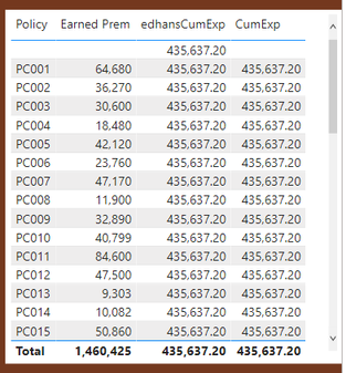

I have a measure calculating monthly cumulative, but when I put it in a box, it gives the total for the selection against each policy, but I want to see the calculation against each.
See here, CumExp (Cumulative Expenses) should be 11,197 for the total. But it's putting that against each.

CALCULATE is redoing the date determination in your measure.
Try this. There is no need for CALCULATE here, and this should properly get the current date for the <= determination later.

Thanks for your reply. Still not working. Here's yours v my original. Only difference is that now I have a blank field...
(i've left the filter off, so showing all)
I can't be certain without seeing your data model, but I think the problem here might be the ALLSELECTED, which works using the Slicer and report filter context, but not the policy row filter context of the matrix, so if Policy field that you are using in the matrix is not contained in the Costs table, you would get what you expect/want, but if Policy field is in the Costs table, then the ALLSELECTED will give you the total cost for all policies.

Thanks for your reply. Still not working. If I bring in Policy from another table, it shows ALL policies, but with empty fields against all except the two I've filtered on..
It's so frustrating!
