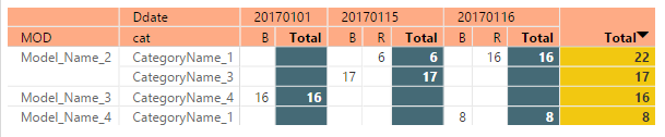

Hi ,
In below image matrix grouping by rows and then sort by value. But it is not useful for my client. 8 value should be after the 16 but it is before in current logic. Can you please help me to fix it?
Correct order should be 17 - 16 - 16 - 8
@aslan wrote:Correct order should be 17 - 16 - 16 - 8
If you want this order you need to swap the order in the Rows Field of you Matrix.
You currenty have cat/mod - you need mod/cat - but then I don't get how 6+16=16 on the 3rd line in your picture below the 8?

I really don't understand in your comment what you explain? Is ıt possible in PowerBI or not?
