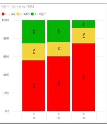

 For example,
I would like to see just the % of High (green) over time for 5th grade. In the stacked 100% chart the %s are showing properly as 25%, 24% and 8% for R1-R3.

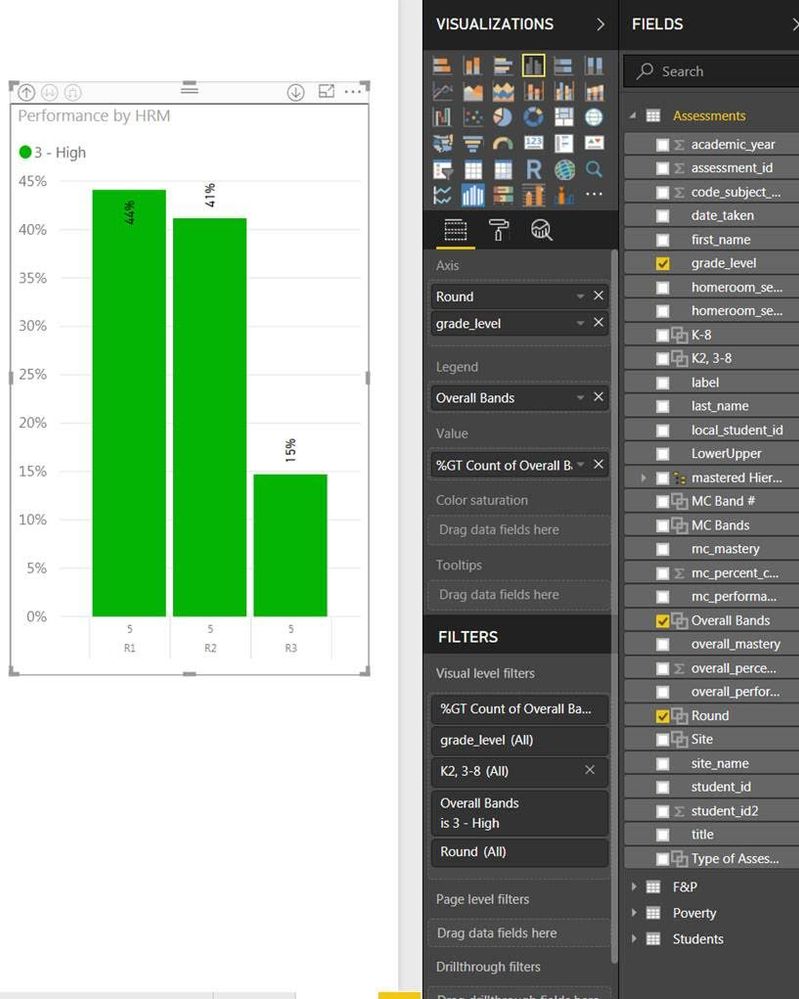

When I try to change the chart to a bar chart and filter out the Low and Mid categories from the Overall Band, the COUNTS are correct, but when I try to make it into a % visually, it doesn’t work.:
When I change it to “show as % of grand total” it uses the full count (15+14+5) as the denominatorhrm 3.jpg

The issue I am having with the filters is that soon as I click them it takes out all the other data so the %'s show only in relation to what is left.  The first graph I show was just to illustrate the correct %s but any seperated graph showing the %s for each is totally fine also.
Ideally what I would like is the ability to just show the green columns you see and hide the others without changing any of the data so hide rather than filter, this would allow the data to remain the same.  Is that at all possible?
