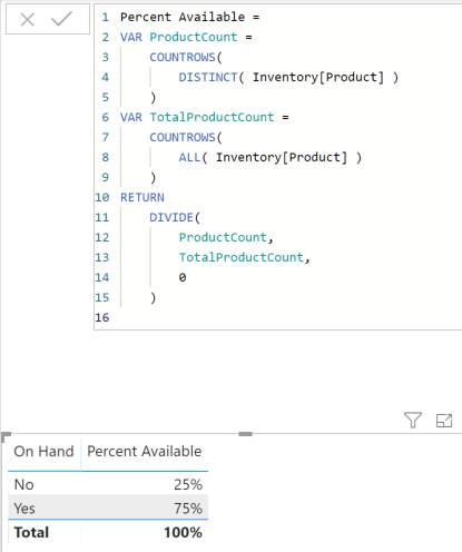

Then I created a table visual, dropping in the "On Hand" field from the Stock Status table, and the Percent Available measure from the INventory Table, which is the following measure:
Percent Available =
VAR ProductCount =
    COUNTROWS(
        DISTINCT( Inventory[Product] )
VAR TotalProductCount =
    COUNTROWS(
        ALL( Inventory[Product] )
    DIVIDE(
        ProductCount,
        TotalProductCount,
        0
my PBIX file is here if you want to tinker with it.
