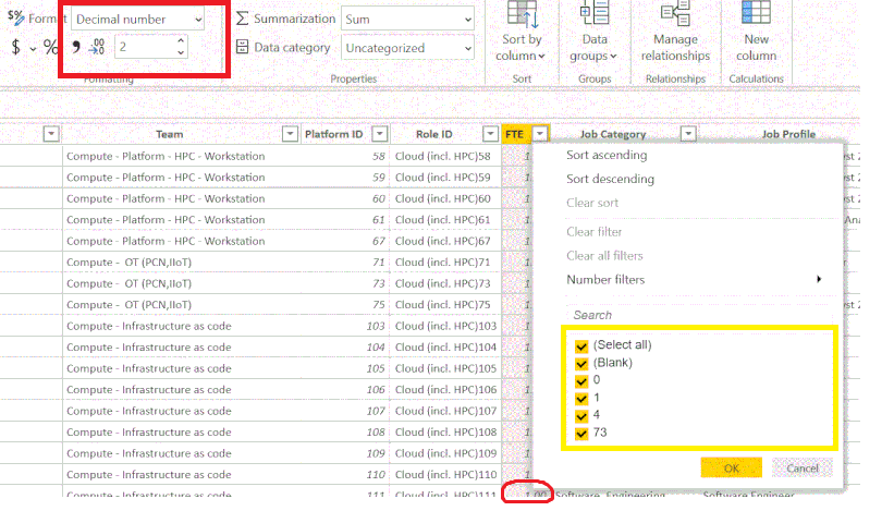

Integer not Converting to Decimal

Hi Nosh10 ,
It seems like you have changed the data type and adjusted the number of decimal places in power bi desktop, it looks like normal.
Did you mean it not work in the filter like the yellow part?

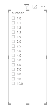

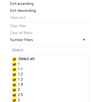

If so, when the initial data is 1,2,3.. , even if you change the data type as decimal number, it will not reflect in power query editor and data view filter. However, you can see the 1.0, 2.0, 3.0 ... in the slicer visual.
data view filter will not reflect the initial 1 as 1.0slicer can do it
