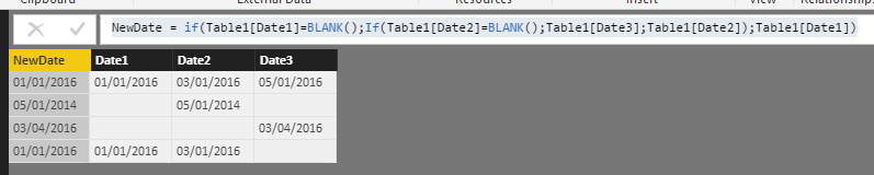

I have 3 columns with different dates. I need a function that:
IF Column Date1 is empty, take Column Date2, and if this one is empty, take Column Date3.
If i use Column(Date1)="", it says DAX comparison cant compare Date with Text, the same happen when I use 0 or null.

Try using this Dax:
NewDate =
IF (
Table1[Date1] = BLANK (),
IF ( Table1[Date2] = BLANK (), Table1[Date3], Table1[Date2] );
Table1[Date1]

I tried using your DAX to create this and received an error "A single value for column 'Date' in table '[Table]' cannot be determined...
I tried using it as a new Column and as a new Measure. Any suggestions?
Thanks, it works perfectly!
That error message means that the formula you wrote would return two different data types. You've done something like
NewColumn = IF(TableName[ColumnName] = BLANK(), FALSE, TableName[DateColumn])
In that example, one condition would return a true/false value and the other would return a date. A single column can't contain both. It has to be either true/false or a date. I have no idea what you've actually written but it's something like that where the two return values are different types. Your two return values both have to be the same data type.
Thanks, you're right, my mistake was that one of the table was store as Text.
